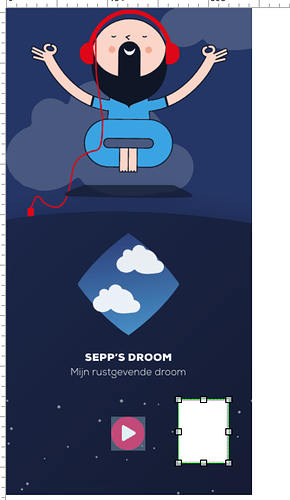

make sure you have a playbutton in your Axure file and an inline frame (set it hidden).
Use the on click event on the play button “open link in inline frame external hyperlink”
