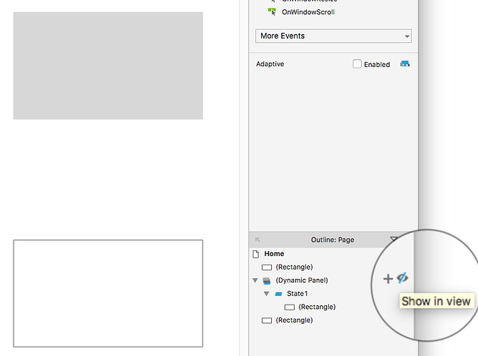

Probably not your problem:
But it took me a while to figure out you could hide elements in the outline panel.
There you can show and hide elements in the preview.
