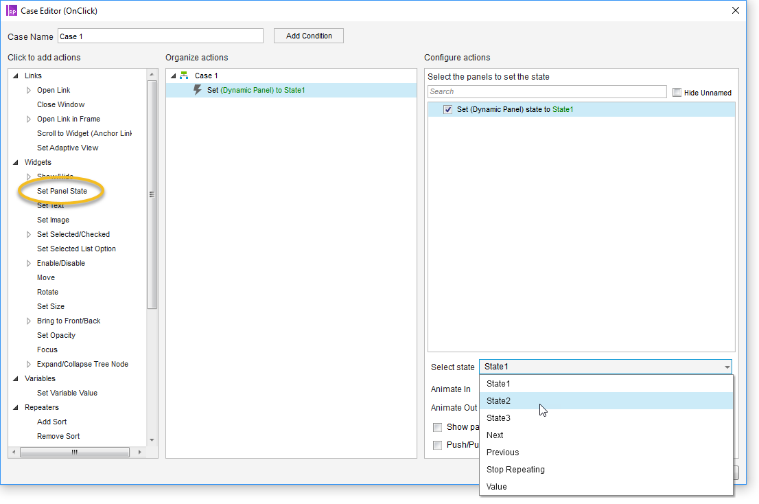

Yes, you can change the state of a dynamic panel by using the “Set Panel State” action in the Case Editor dialog. You can specify the name of the state, Next/Previous, or a number (the state’s value, where “State1” is “1”, “State2” is “2” by default.)
You can learn more about controlling dynamic panels in this tutorial:
https://www.axure.com/support/training/rotating-carousel-banner-tutorial
