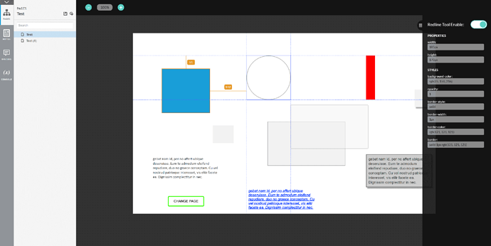

I know this doesn’t help with accurate intra-element measurements within Axure but it does help when passing off files to developers. I hope this tool might be useful to you all! As a note, it’s still in its infancy and the user base isn’t huge yet so I’m sure you’ll find improvement opportunities along the way.
