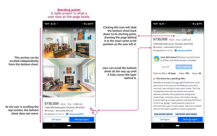

I want to have the bottom sheet peak out on the bottom of the screen as the user enters the page. The user can interact with anything on the page as usual, and if they want to see the mobile bottom sheet content, they swipe it up from the bottom to bring it into view. If they swipe it up all the way to the top, they should see an “X” button to get it back down, or they can scroll all the way down to see the ‘starting point’ page again.

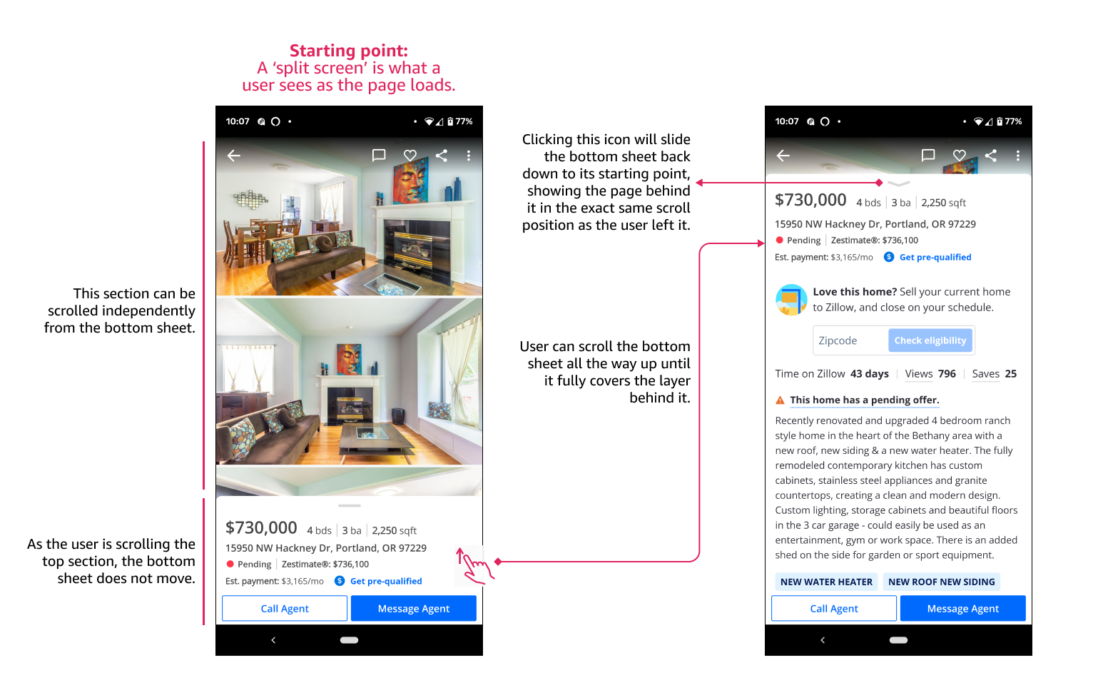

Hi @Bahcos, thank you for your reply! I wasn’t able to get this to work, maybe because of the 2 layers of scrolling I am trying to achieve. Appreciate any guidance! Zillow has an example the interaction I am trying to get. I am attaching some screenshots.
