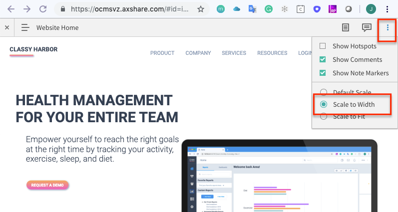

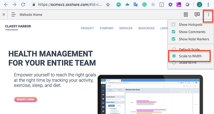

We’ve added in features to be able to scale your prototype to fit the screen (desktop/tablet/mobile) but you can’t do this if you’re linking directly to the HTML page. You’ll be able to get a URL you can send that will scale properly across devices if you enable the option to “Scale to width”.
Here are steps to do that:
Visit your Axure Cloud hosted prototype.
Click the “Ellipsis” button at the top-right.
Enable “Scale to Width”
Here’s a screenshot of that in the prototype player
If you enable that option, it will modify the URL by adding “&sc=1” to the URL (if you share the URL, it will automatically have “Scale to Width” enabled.
Also, if you don’t want the prototype player bar to show up, you can hide it by clicking the “X” to the left (this will modify the URL as well).
Can you try enabling “Scale to Width” , closing out the prototype player, then entering the new URL into your mobile device?
