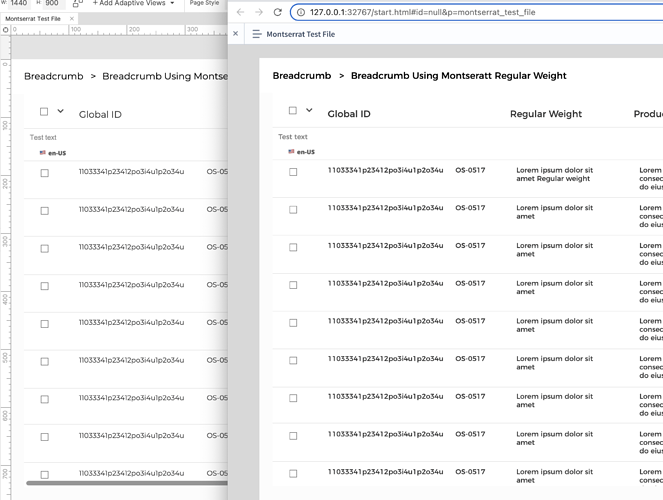

It looks different when rendered from what it does in the Axure file - it appears as a heavier looking weight when rendered in browser.
Since it’s a Google Font and web safe, I did not map it. I did try to at one point, which created stranger issues like your issue with widget container showing less wide in rendered version than it does in your file. I removed the mapping, which resolved the additional issue the mapping created, but original issue - with it appearing as a heavier weight - remains.
Below is a screenshot that shows the side by side of how the font appears in axure file (RP 10) vs how it appears rendered in the browser. Render issue is same when saved locally or published to Axure Share URL.
Here is RP 10 test file. Montseratt Google Font Render Test File.rp (179.7 KB)
Here is the axshare file URL for render preview: Axure Cloud Redirect
Below is screenshot of side by side (Axure file on left, rendered in browser on right).
So, I was able to resolve my issue:
I had reached out to Axure support. While they hadn’t been able to replicate the issue, they came back with a list of things to check and in doing so it occurred to me that perhaps my Montseratt font installs, which I installed years ago, were dated and something had changed causing this issue. I deleted all Montseratt fonts from my Mac, and then downloaded the most current Montserrat version from Google https://fonts.google.com/specimen/Montserrat and installed that.
It resolved the issue for me. It now renders in browser and looks same as in Axure file. :slight_smile:
