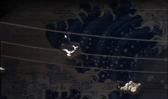

I’ve managed to get the linear movement in place, which works decently - getting a different speed ratio based on distance (for example creating 3 different bands) I think I can potentially work out.
The biggest problem I’m having is with anchoring the movable to a position…
Attached are:
how far I got with it in Axure
gif describing exactly what effect I’m after movable-object.rp (45.1 KB)
Move the widget by negative cursor amount so it goes in the opposite direction.
[[-cursor.y / 2]]
I don’t know what you mean by anchoring it, unless what you mean is that gif, in which case the above should solve it. Also known as parallax, since they move by different apparent amounts based on implied distance from the viewer.
In the gif all the elements are doing the same thing, just scaled by different factors to give the illusion of depth.
Thank you for your time and your help so far, @nkrisc!
I don’t mind how it affects different element - apologies - I should’ve cropped the GIF better so that it focuses only on the relation between mouse pointer and the 2 birds pendant.
I have tried what you suggest (the negative cursor value) but it’s doing something weird - upon mouse enter to the desired area, it somehow resets the default “movable object”'s position to 0,0.
Wouldn’t “move by” always move the object diagonally in one direction?
If it was move by [[-cursor.x]] [[-cursor.y]], it would always keep moving the object to top left on page mouse move, and relatively, if it was move by [[cursor.x]] [[cursor.y]], it would keep moving the object to bottom right?
