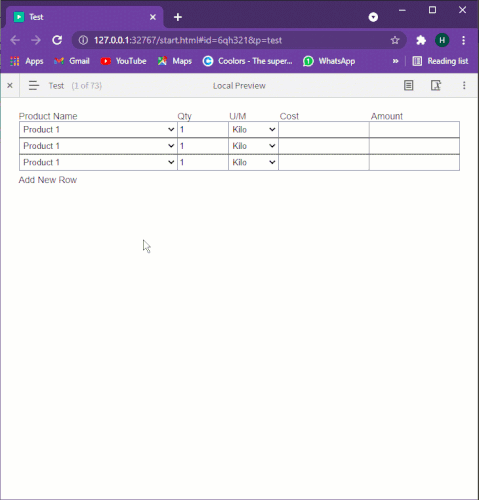

I want to create a editable data grid in Axure RP9.
I have added an “Add row” text label to add new row under my repeater. but when new row is adding the text label is in its fix position. is anyway to move it down?

My “add new row” is outside of the repeater. I follow your steps and it worked for me, but it moves down overmuch.

It looks like the Add Row button is moving down the same height as the repeater. My guess is your Move code is “Move by” instead of “Move to”. Ensure it is “Move to”
