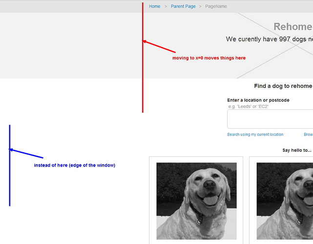

I think you might be right - having the page centered seems to throw everything out of whack. I think it’s due to the way 0 is handled. An x value of 0 seems to be the left edge of the ‘body’ div, rather than the edge of the window.

I have a similar problem, except I don’t want my element to be sticky and move with scrolling.
I just want to move it to the window 40px x position.
My whole page is centered for other reasons, but I want a responsive header and the logo to be at the same place on the left side.
onPageLoad > move to > x=0 moves it to the centered page left, not to the window left.
How can I move it to Window x=0 coordinate?
