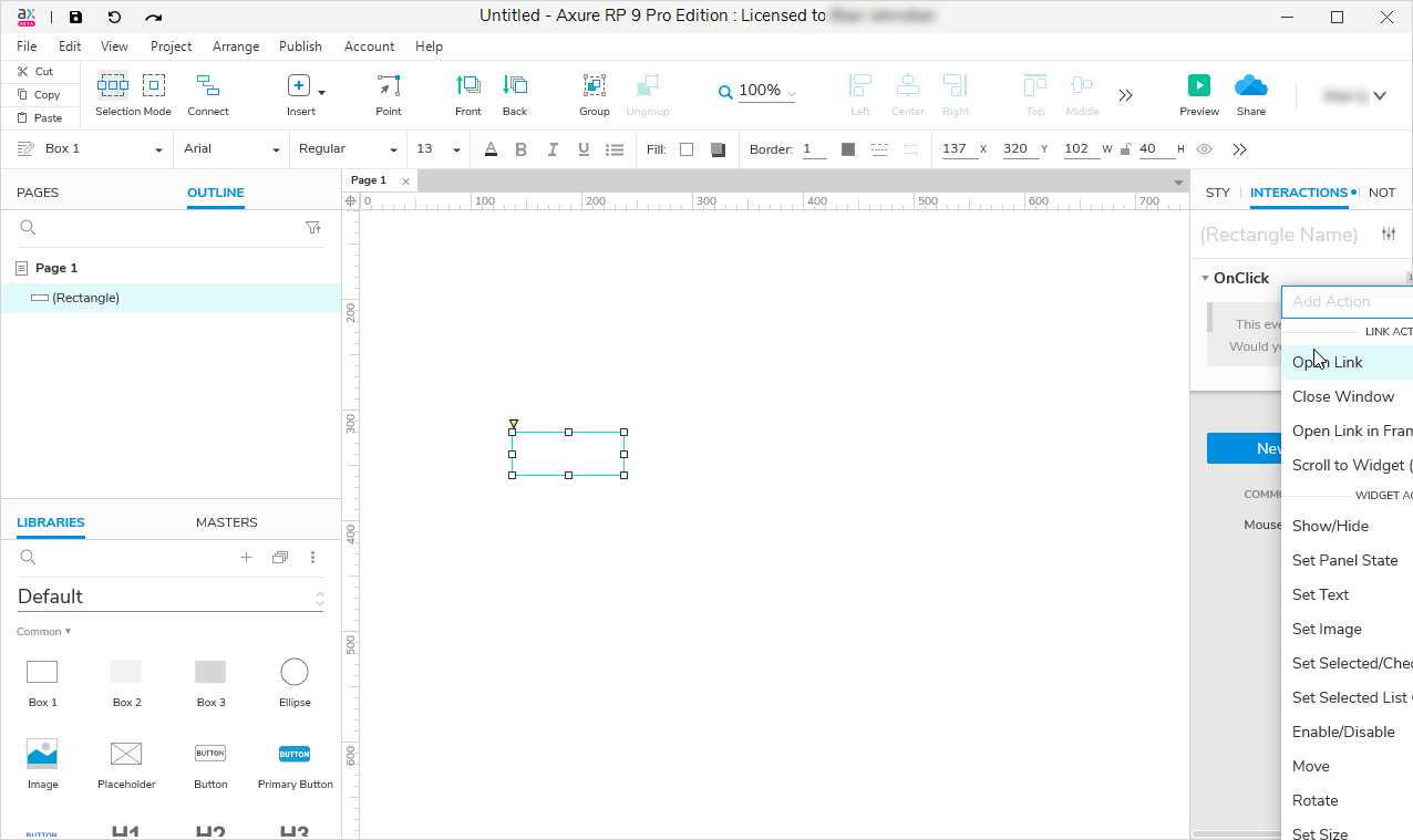

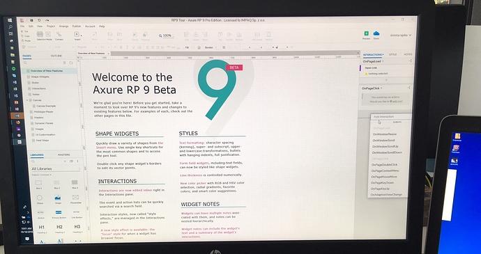

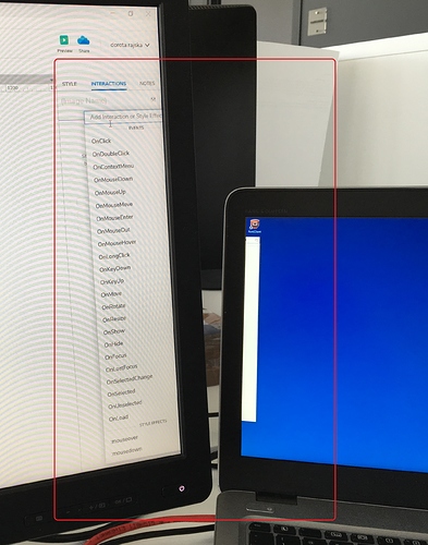

Hi, I have two monitors. Left - primary, where I use Axure, right, secondary.
Now that Interactions are popping out from the right hand panel, they extend to the next monitor - this is very difficult to use.
I mentioned interactions as it’s the most frequently used feature but it applies to all pop out from the right hand panel.
Multiple displays - problem with the right hand pane

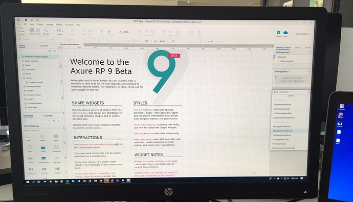

I think I know what the problem is!
It’s not a case of multiple displays, its the task bar placement.
I like to have my task bar on the left. That’s when the Interactions pop out and are cut. When I move my Task Bar to the bottom everything works fine.
It would be great to have that fixed, a left side Task Bar is very convenient, but surely I could move it down as a workaround.

Hi Dorota,
Thanks for sleuthing this! I see the same behavior as you, where moving the Windows Taskbar to anywhere except the default bottom (e.g. left) cuts off dialogs, and I’ve filed this with our QA team.

I am seeing the same thing. I keep my task bar on the left and the interaction builder is always cutoff…I have to go out of full screen and leave room to the right of my window…
Beta9: 9.0.0.3633
