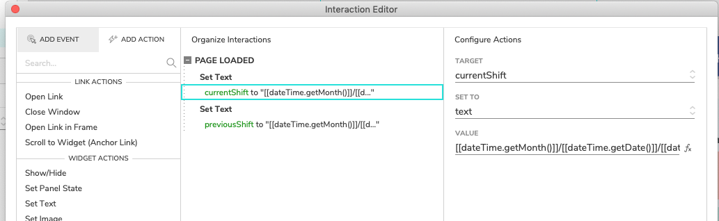

I created a Global Variable called dateTime and left value empty
On the page I created an interaction OnPageLoad
set Text currentShift to your info
than
set Text previousShift to your other numbers

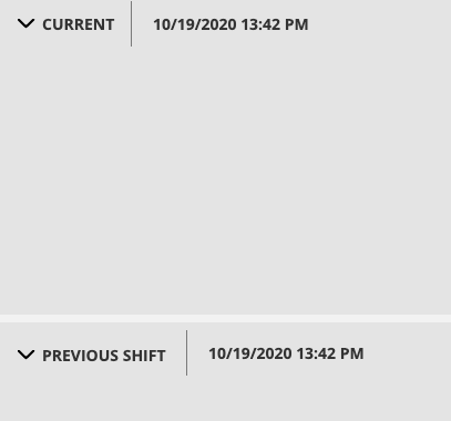

I must be dense. This is what I did.
And this is what I got
You are on the right track. But you need to set dateTime again before the second Set Text, this time setting it to 12 hours ago. Look again at my code sample.
