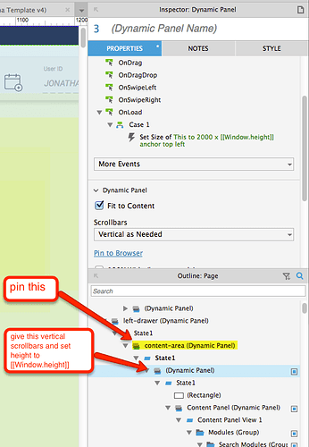

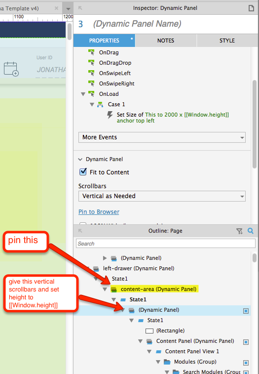

I agree with jhelmer’s suggestion to separate any of the top header content that needs to be stationary into its own pinned dynamic panel. That way, the content would remain in place, and you can have the content area (which would be separate unpinned content) scroll normally.
With your current file, you can get close without breaking apart the panels by pinning the content-area panel, and then adding vertical scrollbars to the panel inside of it and shrinking its height so that it can actually scroll:
This seems to keep the content from scrolling over the top of the blue headers up top. Hopefully that helps!
