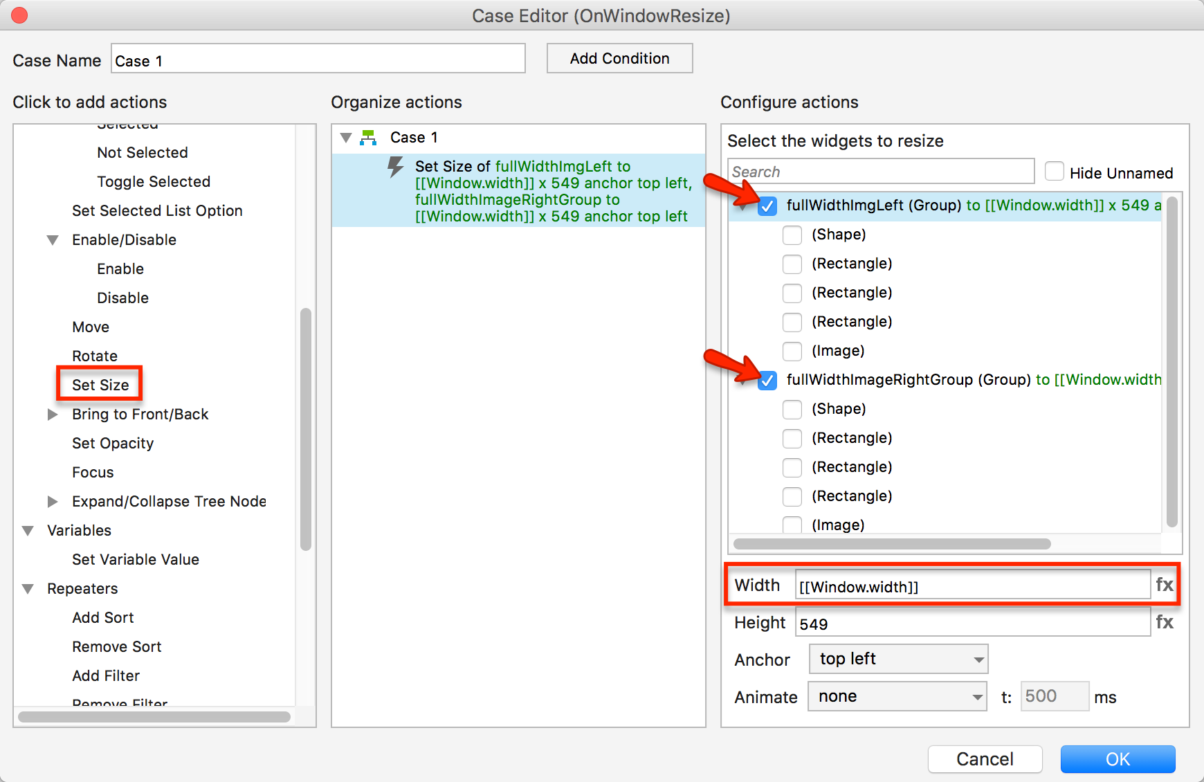

Hi Michael,
You can try using a “set size” action in the “OnWindowResize” page event to set the width of your groups to the variable value “[[Window.width]]”. The OnWindowResize event is triggered whenever the prototype’s page is loaded or resized and [[Window.width]] returns the current width of the window, so this would set the width of your groups to match the width of the window:
I attached an edited version of your file with these changes below. Feel free to check it out and let me know if you have any questions!
