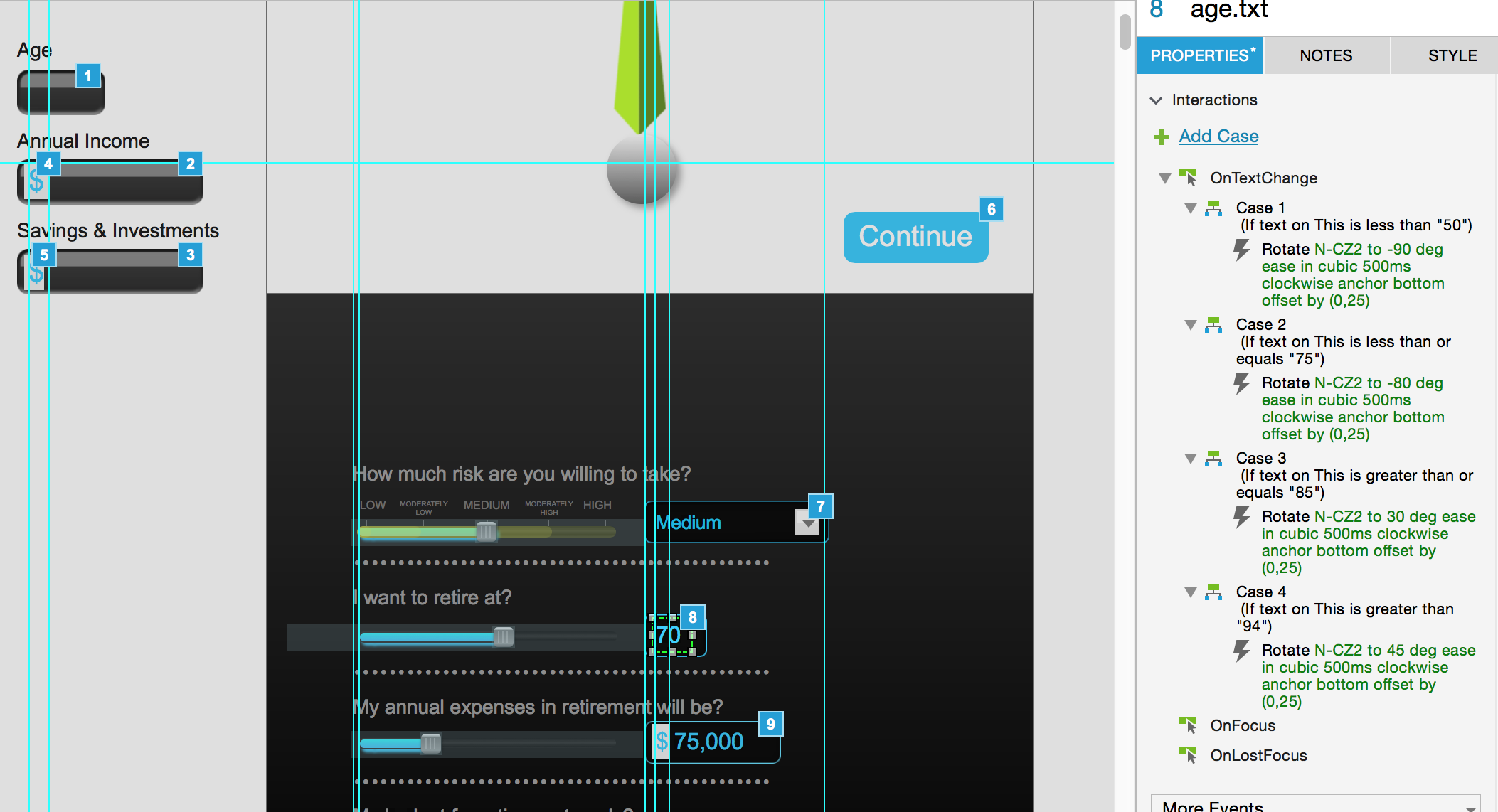

There’s a lot going on here so I’ll try to explain in as much detail as I can. When the user arrives, some defaults will be set based on the previous screen & the gauge will land somewhere based on this. When user moves the sliders around, the gauge should move logically. The first section, risk works fine. The second section, age (age.txt -image attached)dial.rp (506.7 KB)
does not move correctly. The first case says if text on this is less than 50 then rotate back to a certain position. What happens though, when you move the slider to a number lower than 50, the gauge bounces around that many times. For example if I moved it to 45, the gauge would bounce back and forth 5 times before it stops. If I set it to 30, it would bounce 20 times, etc. The way it should work, when you move it under 50, it moves to that position and stops but does not bounce around.

In the first screen I have the 3 fields. User enters info and those inputs are carried over to the next screen. In the age slider section, is there a way to make the minimum age reflect the age that a user enters in the screen previously? So in the first screen I enter 35. Inputs carry over to next page and the sliders min age is 35, I can’t slide any lower then that.
