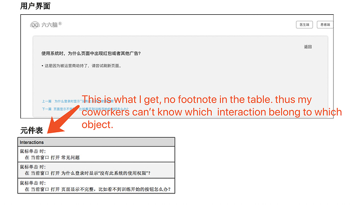

when generating specification , there is no footnotes on screenshot for objects have interactions.
only those objects have notes have footnotes on screenshot.

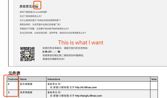

but I want footnotes numbers on both screenshot and in widget table just like in axure rp 8.0.
My temporary solution is to give notes to all objects who has interactions .

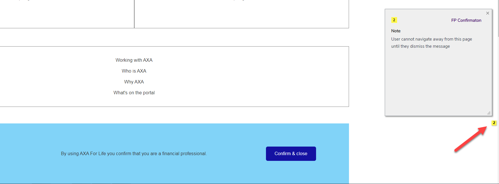

I found the note! It was stuck to the right edge of my screen.
I didn’t realize I needed to scroll to the right to find it.
thanks! but I didn’t mean that, I mean the footnote in the specification word:

Thanks for attaching the .rp files! I see what you mean now. It looks like the 9 beta doesn’t give widgets that don’t have notes numbered footnotes, which I can see is problematic when generating the Word specification for those widgets. I’ll go ahead and pass this along to our product management team for further evaluation.
In the meantime, adding a note to each widget (as you’re doing) would be the best way to get those footnotes icons to show with each widget in the specification.
