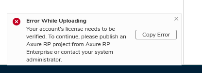

i’m getting an error when trying to create/open a team project from the Windows Axure Client
“Your account’s license needs to be verified.
To continue, please publish an Axure RP project from Axure RP Enterprise or contact your system administrator.”

@knobiwu and I are in contact about this. This is an Axure Cloud for Business or Axure Cloud for Business On-Premises specific error. When managing users, you can Enable Axure RP Enterprise for a user. This flags the account in Axure Cloud for Business and states that the user has an Axure RP Enterprise subscription, which means that specific account does not count toward the monthly user cap for Axure Cloud for Business.
To verify that the user actually has an Axure RP Enterprise subscription, they must publish from Axure RP.
In this specific case, since there aren’t any Axure RP Enterprise subscriptions being used, the way to resolve this is to disable Axure RP Enterprise for that specific account. To do that, follow these steps:
Log into Axure Cloud for Business as an Admin or System admin.
Go to Admin Settings
Locate the account and click the ellipsis button on the right side.
