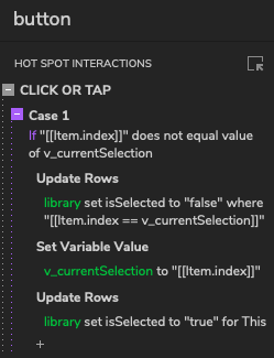

Start with all isSelected rows set to false, and create a global var called v_currentSelection, and default it to 0 or just blank (anything but a positive number). Or, if you want, say, the first row to be selected by default, set the row value that way and default the variable to 1.
On Clicked
If value [[Item.index]] does not equal value of variable v_currentSelection
Update rows set isSelected to "false" where [[Item.index == v_currentSelection]]
Set value of variable v_currentSelection to value [[Item.index]]
Update rows set isSelected to "true" for this
Hi,
so this approach has still bad performance as you said.
this approach is working better as long as a only click one after the other in one direction. If I select an item which is before the currently selected, it won’t be selected.

Hi!
My bad: change the update rule to [[TargetItem.index == v_currentSelection]]
ah now I got you. Thats really good to know. Thank you for your input.
