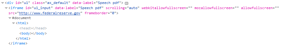

Thank you, Alyssa. I’ve been trying that approach without success. Just set it up and tried again, but no go. Here’s what the rendered html looks like:
To confirm, is it not working in the local preview or on Axure Cloud? If it’s failing on Axure Cloud, please right-click the page, choose “Inspect” to open the web developer tools, and open the “Console” tab; does that tab show any errors? One thing that comes to mind is that since Axure Cloud is HTTPS-only you may be getting a mixed content error if the link you’re using is trying to use HTTP instead of HTTPS. In Chrome, when you try to load the HTTP link on Axure Cloud it should show in the browser that it blocked the insecure content, but you can choose to show it anyway:

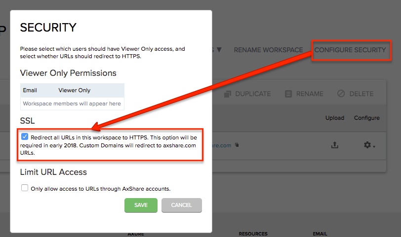

Another way to get the HTTP content to load would be to publish the project to a shared workspace and turn off SSL for that workspace on classic Axure Share; note that this feature is deprecated in the new Axure Cloud and can only be toggled via the classic Axure Share site, but should help for now:
