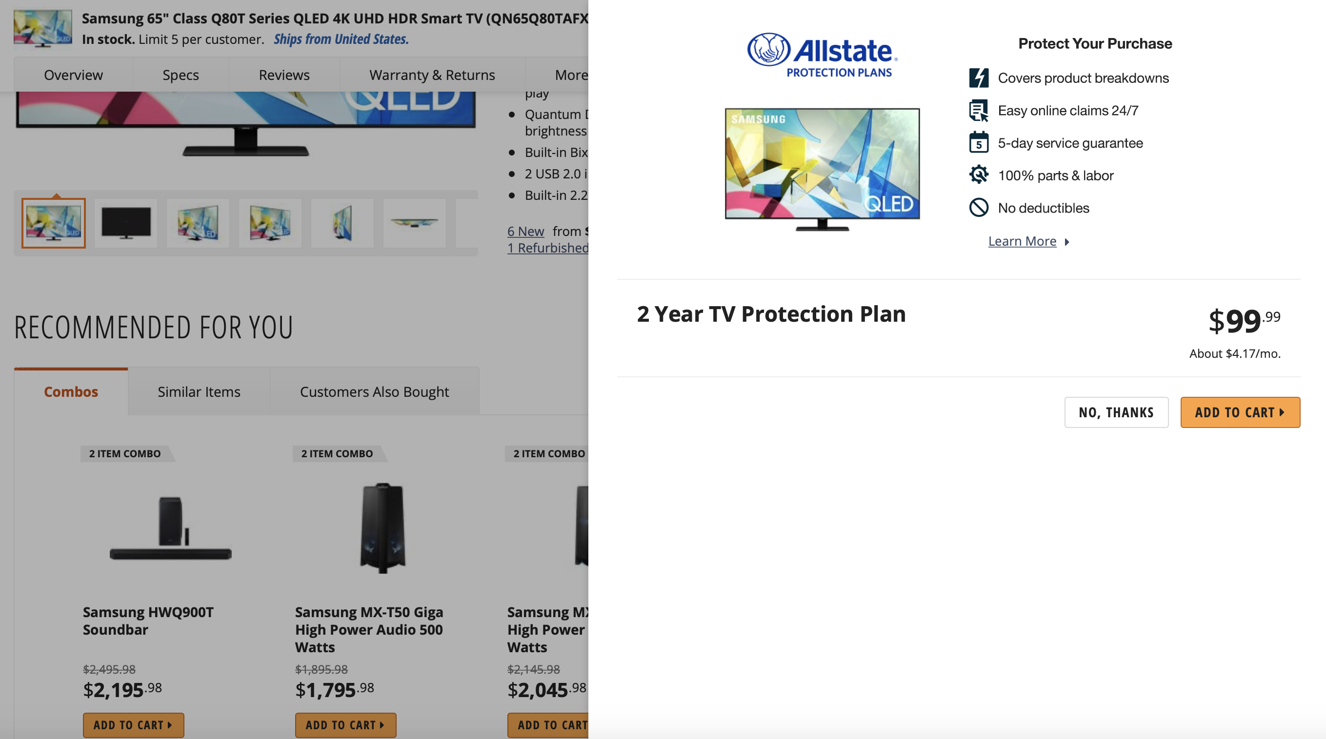

Hello! I would be super grateful if someone can help me with this solution - I am doing a prototype of a product detail page. I’m absolutely not advanced but tried so many options and nothing helps - the solution looks buggy or doesn’t work smoothly.
What I need (DESKTOP):
Once clicking on a button, a flyout (modal, overlay) shows up from the right side (and stays sticky on the right) and covers the page like an overlay. The content of the flyout itself should be vertically scrollable. Ideally, the content of the whole page (background) shouldn’t scroll. To imagine - a similar pattern is used e.g. on amazon or wayfair once you click on the add to basket button on the detail page, you get a summary and other options in this overlay that slides and stays on the right while you can scroll it.
What worked for me for now: flyout as a dynamic panel that slides left “as a lightbox” after clicking a button. I used “pin to browser” with an option to scroll vertically. It works fine unless I change the window height (use another monitor / window size) - then I can’t scroll/reach the bottom of the overlay, so it is cut on the bottom. What am I doing wrong? Is there a way to do it smoothly for different windows sizes?
Thank you in advance.
Daria
(the screenshot demonstrates what I need, but I have more content and therefore need to enable a proper scrolling)
