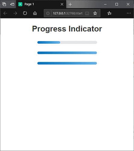

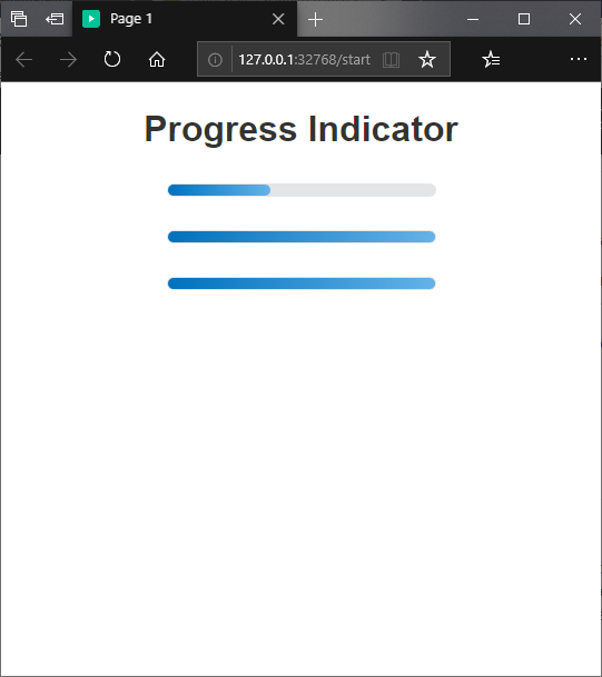

It’s working for you? For me, only the first one loops infinitely. The second progress bar fills once then stops and never starts again. That’s the issue I’m having. I’ve tried it in Edge and Firefox.
I’ve attached a screenshot showing how they get out of sync after the first fill.
Also, without waiting longer than the duration of the Set Size action, you never see the animation. Setting the panel then to Default, which resets the progress bar back to it’s original position and then back to Uploading is what restarts the fill.

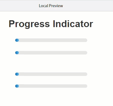

Yes, works fine for me. Win10 and latest Google Chrome browser. in your file, I copied one of the progress bar dynamic panels, then I copied that copy and removed the Change State action in Case 2 (change to Default state) to test if it would run once and stop without looping, which it did.
Here is a screen capture:
