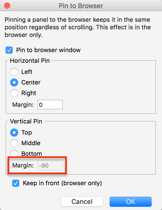

Hi RainbowMoonbeams,
It sounds like your dynamic panel might currently be pinned at a location outside of the canvas. If the dynamic panel itself is placed at a vertical location outside of the canvas, pinned location of the panel in the browser will automatically adjust to reflect that. You can check this in the panel’s “Pin to Browser” options:
To adjust this while keeping the vertical pin set to “Top”, you’ll want to move your dynamic panel accordingly (e.g. move the panel to a y-location of 0 if you want the margin to be 0).
