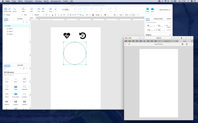

I’m testing Axure 9 and see some items don’t appear on the preview (as you can see on the following image). Is it an isolated issue or a beta effect ?

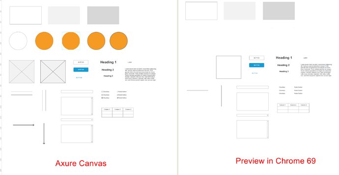

in the preview (also in the rendered version) the display of some items doesn’t work yet. It’s strange that only a few have posted this so far.
The following screenshot shows the Axure file on the left and the preview in Chrome on the right (but Firefox and Edge are identical):
Good to see is that circles are not displayed at all (the generated image is simply transparent and empty).
Also 1px lines and radio buttons and checkboxes are not displayed.
