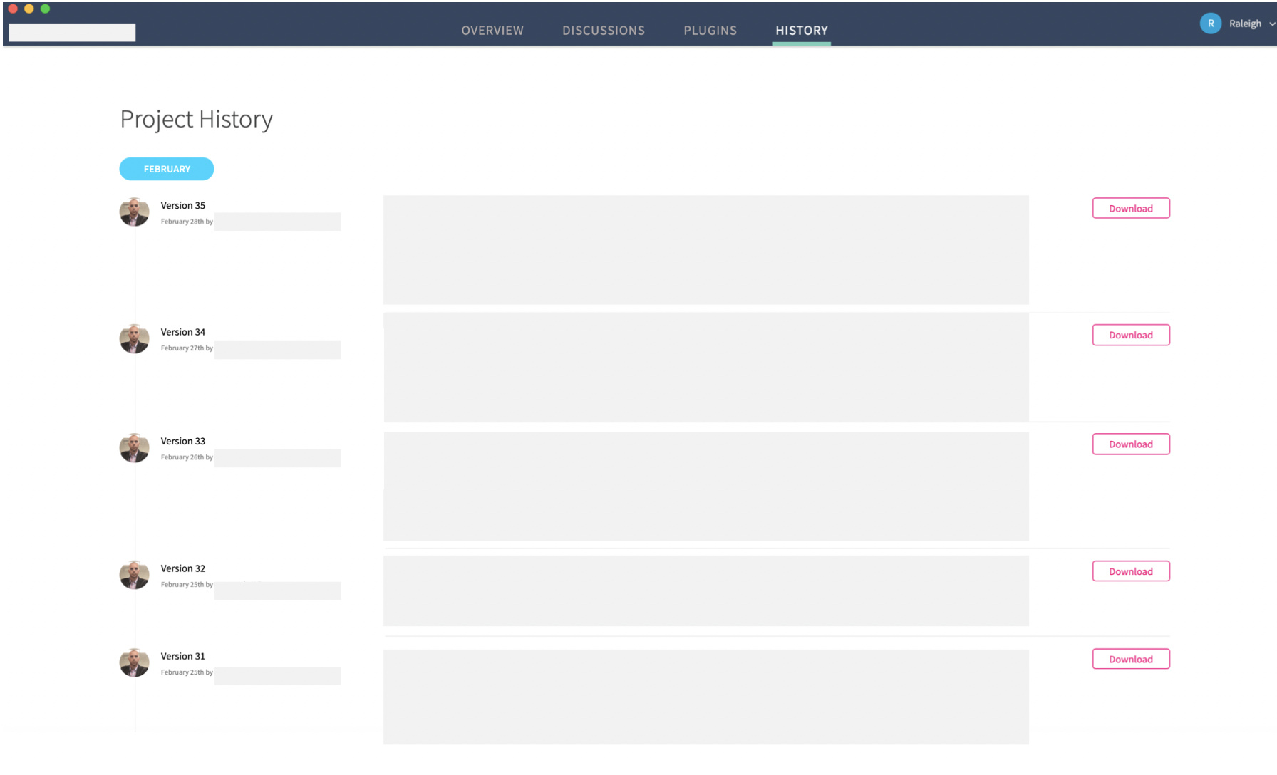

Hello @josephxbrick,
Happy you like the new history page!
Some additional good news, for team projects specifically you can download previous versions as well (see screenshot below - I have greyed out some areas as it’s an internal document but the download buttons on each version show what you are looking for).
All the best,
Raleigh
