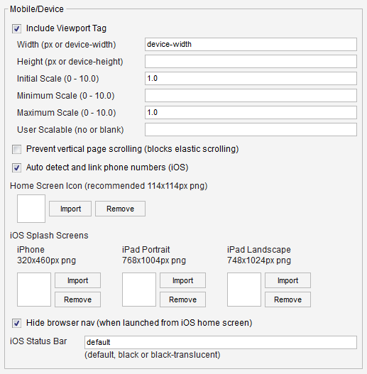

Is there a way to publish only in the 320 adaptive view without the base desktop view?
I tried to select only the 320 view, but it doesn’t allow us to unselect the base view. When I open the link on my android phone, the default is still the desktop view. Did I do something wrong with the viewport tag?

Hi mmessier,
While only the child views can be de-selected in the HTML generator options (the base view is always generated), the appropriate views should still be displayed if your screen size is meeting the adaptive breakpoints. If you’re seeing that the 320 view of your prototype is set to be generated but isn’t being displayed when you’re viewing it on your Android device, would you be able to post a copy of your RP file? Having the file will allow us to take a closer look at what might be going on. It may also help to make sure that the device you’re viewing your prototype on does indeed have a screen size of 320px wide, as some operating systems do apply a scaling factor.

We are now testing on larger phone than 320px. So I tried to set the adaptative view at a larger width and it seems to be working now.
