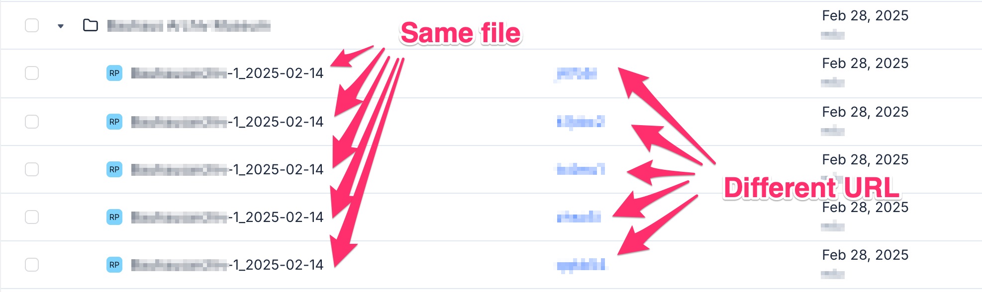

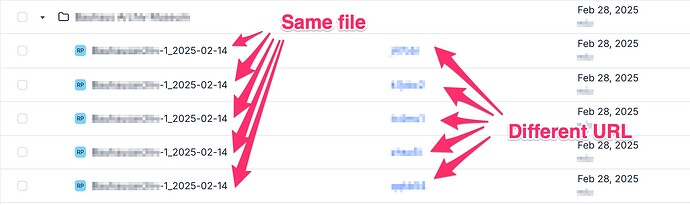

I have the same behaviour. It started when i upgraded to RP 11. I store my files locally and have not changed my workflow.
MacOS 14.1 (23B2073)
Axure 11.0.0.4122
For three weeks or so RP is creating a new instance for every update from this file. File was created with the rp11 beta.
I ceated a new fresh document and it updates fine. Next I will try to transfer the old file to a new document. I am afr loose all my styles, though.
