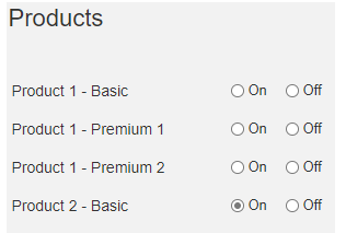

Wouldn’t someone with a radio in the repeater help me?
Thank you Tom
Trial.rp (64.0 KB)
Hi!
You need to do two things in order to get the radio buttons to behave like radio buttons:
Perfect. Thanks a lot Tom
And I have one more question. If I click on the marked radio again, it will be unmarked.
Thanks
So solved

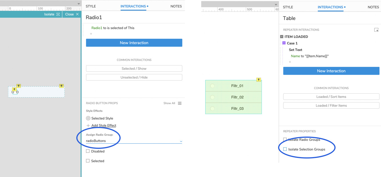

Hi can I ask what version you’re running.
I’m running 9.0.0.3701, have my radios in a radio group, have “isloate radio groups” set on the repeater and can’t get it to behave as expected. I’m setting the status of the radio in the repeater’s onloaded event, and within Axure it appears to be correctly. But when I preview it in a browser, it seems as though “isolate radio groups” is ignored.
Inside Axure
In browser preview
