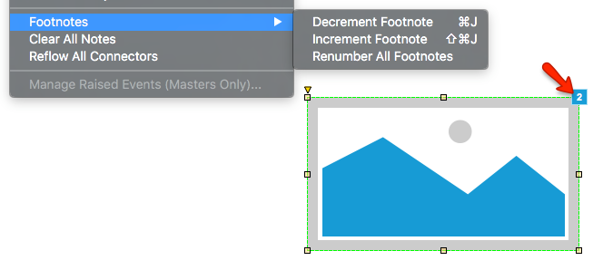

Instead of according to their z-index (a.k.a. their order in the Outline pane), the items in the generated Word spec’s widget table are ordered according to their footnote number such that the widget with the footnote number “1” will appear first in the table and the rest will follow in ascending order. The “Arrange > Footnotes > Renumber all Footnotes” option Alyssa mentioned will automatically re-number all of your widgets’ footnotes, but you can also manually order them for a specific widget by selecting the widget and then using the “Arrange > Footnotes > Increment/Decrement Footnote” options:
