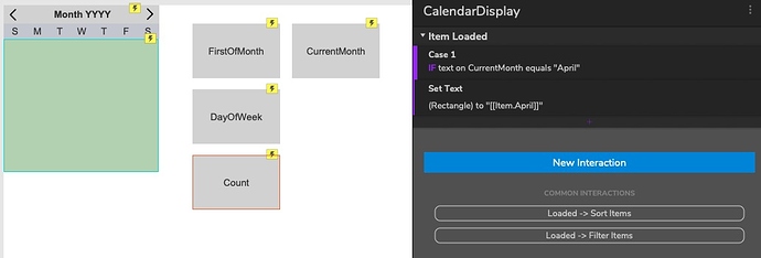

thanks for responding back. i did upload the file. the idea is im trying to display a column from the repeater based on the variable. so…
If April display the April column, if January, display the January column
This kinda hits on it with the conditional logic
@jbzolla3, The file you uploaded does not quite match your screenshot. In your screenshot, you show that you’ve solved your issue and this would work to fill the repeater with the contents from the April column.

  1. You have a Set Text action in the repeater’s Loaded event, which should only result in every cell in the repeater being set to the same value. Use the Item Loaded event, as in your screenshot.
