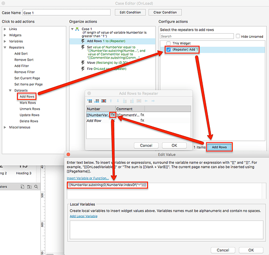

The Repeater’s First OnLoad Case
When the page is loaded, the repeater’s first OnLoad case begins by using the variable values to add rows to the repeater:
[[VariableName.substring(0,VariableName.indexOf("~"))]] selects the portion of the variable value from the beginning to the first tilde, i.e. the first individual row value. Once that row is added, the “Set Variable Value” action removes the first individual row value from the variable with the expression [[VariableName.substring(VariableName.indexOf("~")+1)]], which sets the variable value to only include whatever comes after that first tilde. Now, the second individual row value is the first, and it gets added to the repeater when the OnLoad case fires itself again with the “Fire Event” action at the end of the case.

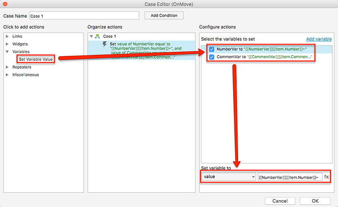

The Repeater’s Second OnLoad Case
The repeater’s first OnLoad case continues to loop until one of the variable values contains no more characters, i.e. until there are no more individual row values to add to the repeater. At this point, the repeater’s second OnLoad case fires, moving a rectangle in the repeater—this could be any widget in the repeater with an unused OnMove event—by (0,0), triggering its OnMove event:
This case uses a “Set Variable Value” action with the expression [[VariableName]][[Item.CorrespondingColumn]]~ to build the variable values back up, allowing the repeater to be repopulated again on subsequent page loads. Because events on widgets in repeaters fire in item order, the individual row values will be added to the variable values in the correct order.
