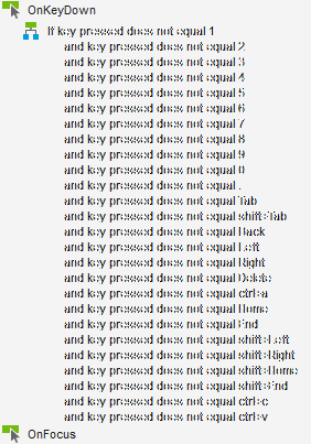

Hi Kyle -
I don’t know how to make the numeric keyboard come up for mobile, but you can restrict entry of keys by testing for them OnKeyDown. Basically you test for various keys or key combinations; only keystrokes that don’t pass the test will be allowed. (You don’t need a command after the condition.)
The following will allow only numbers, the decimal place, and keystrokes that perform normal field operations (e.g., selecting all with ctrl+a, copying, pasting, etc.):
I know, not intuitive.
Live sample.
File: numbers_only_field.rp (59.6 KB)

Hi!
I updated this to allow numbers from the keypad in addition to those on the keyboard’s top number row. (OnKeyDown sees these as different keys.)
numbers_only_field (1).rp (59.3 KB)
