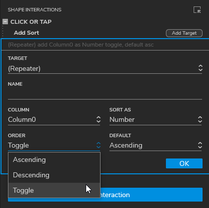

Yes, in the Add Sort action you can choose the sort order. If you choose “Toggle” you can also specify the default sort order:

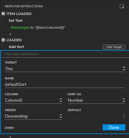

So if you are adding new row/s you can either immediately follow the Add Rows with an Add Sort or you can “bake it” into the repeater by adding it to the repeater’s Loaded event (which gets called on the initial repeater load after all the Item Loaded calls (one per row in the repeater’s dataset.) Something like this:
