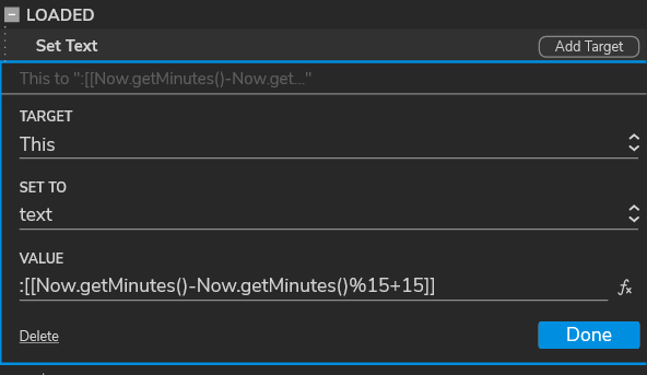

I need to show a next available time/opening in my prototype.
It needs to take the current time and round up to the next quarter-hour time (ie., next 15-minute mark: :00, :15, :30, or :45).
I haven’t found a way to do this yet (using Axure 8) and would appreciate any help here.
Thanks!
Hi @Jodeo ,
use a “Set Text” action with the following formula:
:[[Now.getMinutes()-Now.getMinutes()%15+15]]
Here a prototype with the behaviour and a check for the possible values of minutes (0, 1, 2, … 59):
