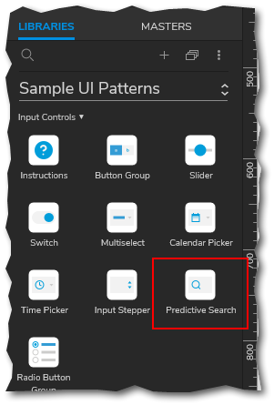

If you have Axure 9, there’s a library for “Sample UI Patterns”. There’s an example of predictive search there.
@huban absolutely amazing tipp! Thanks a lot for this, you made my day!
