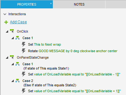

There needs to be some way to keep track of how many panels have been selected, so I just used the default global variable, OnLoadVariable. Each time that a panel is set to selected (a change to State2) it increases the value of OnLoadVariable by 1 and each time it is deselected (a change to State1) it decrements OnLoadVariable by 1. Now we can tell at any time how many panels are selected.
We also need to test the value of OnLoadVariable whenever a panel is clicked. If it is the fifth panel, show “Good Message” and if there are more than 5, show “Error Message”. (Presumably hide both messages if less than 5 selected.) So, I could have added a few conditions to panel “1” and then copied them to all the other panels, but if the rules need to change or just get debugged, then I would have 10 changes to deal with. So, I decided to implement the conditional tests only once. I could have created a hidden button or widget and fired its OnClick, or used another blank dynamic panel, etc., but instead I made use of the existing widgets. When each panel is clicked it sets its state to Next-Wrap and then it rotates the “Good Message” widget by 0-degrees to trigger the OnRotate event:
When “Good Message” is rotated, it handles the count of selected panels to show the correct message:
