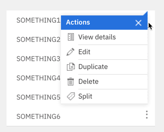

At the end of each rown in the repeater I have a ‘view more options’ hamburger icon like this:
On click of the icon I want a droplist to appear like this:

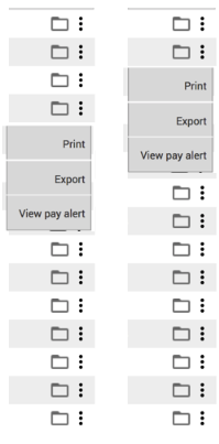

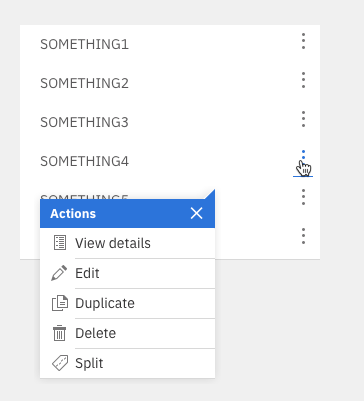

When I have multiple rows in the repeater I want the droplist widget to appear at the touch point where it was clicked, so if I click the hamburger on row 4 it should appear at row 4 and if row 2 it appears at row to like this:
Here is what I’ve tried so far that didn’t work:
I put the droplist in a dynamic panel and inserted the DM into the repeater, onclick of the icon I bring the DM to the front and set panel state from null to state1 with the droplist and this happens, the DM widget pushes the rows below it downwards instead of sitting on top of it like this:

If you put the Menu back into the repeater, then select the repeater object, in the Repeater Properties tab on the right scroll to the bottom. You should see a checkbox that reads something like Fit to Content in HTML. Uncheck it.
Or… if you still need to move the menu outside of the repeater you have to first understand that the inside of a repeater starts at (0,0). It has its own internal coordinates. So what you’ll need to do is reference the repeater’s (x,y) coordinates, then ADD an X-offset (I did 14 pixels), and for Y, multiple the height of the row by the index of the row. So if a row is 34px tall, clicking on row 8 would get you (8 * 34) = 272px.

Yes! Thank you! Very nicely done albeit uncaffeinated
I went with the more efficient choice which is to leave the DM outside of the widget and move to the correct coordinates, it took a little while to tweek but everything is lining up nicely now. The one piece of information that I didn’t know was that repeaters adhere to coordinate internally.
