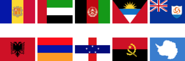

You first have to create a sprite sheet of all desired flags. (The site you referenced doesn’t reveal such a sheet, sadly.) The flags in the sprite sheet below are are arranged left-to-right, top-to-bottom.
Next, create a space-delimited string of all two-character country codes in the same order. For the sheet above, it would be:
AD AE AF AG AI AL AM AN AO AQ
It wouldn’t be a huge task if you winnowed the sprite sheet down to flags you actually plan to use.
Here’s a sample with two versions, the second of which is far friendlier to incorporate into a given prototype.
