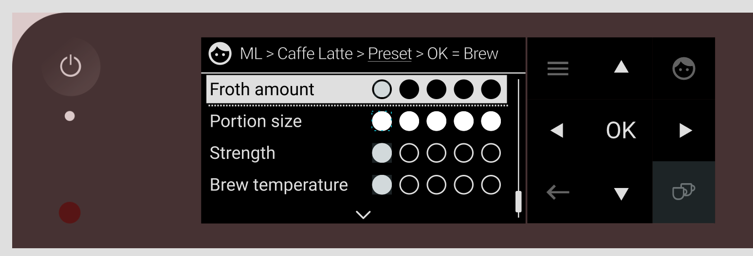

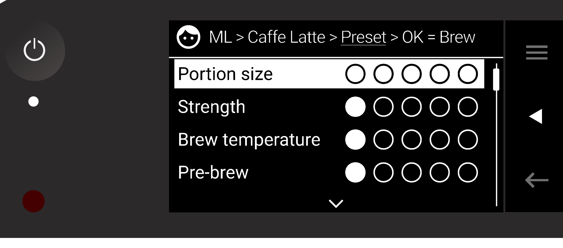

For a project I’m trying to prototype the interface of a coffee machine.
In the machine, you should be able to personalise the parameters of your drink. The idea is that if you press the left or right arrow, 1 to 5 dots are shown/hidden. I did this with 5 different states in dynamic panels. If you then press up or down, you move to the next setting you can adjust. When you move to the next setting, I still want to be able to see the previous adjusted setting if it is in screen.
It’s quite difficult to explain, but it should look something like this:
