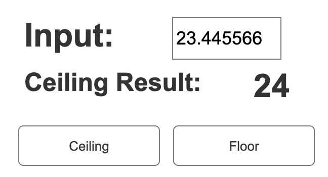

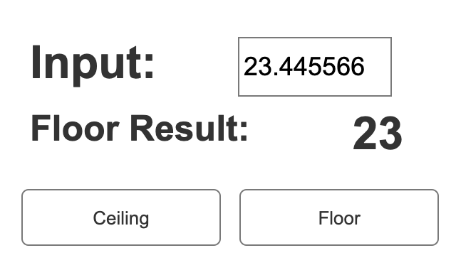

Hi Maxosh,
you can use math.floor to remove all decimal point ( downgrade to integer)
fx example for floor
[[math.floor(this.text)]]
another case is math.ceil to upgrade to integer.
fx example for ceil
[[math.ceil(this.text)]]

You would put it in the text field of the Set Text action. Make sure you wrap it in [[ ]] so that Axure will evaluate it instead of printing it literally.
Math.floor() is a function which returns the nearest integer, rounding down. Just like .toFixed() is a function (or you could say a method of the widget text object) that takes a number as a parameter and tries to parse the text as a number to the specified amount of decimal places. So you pass your widget text to it, and if it can be interpreted as a number, you’ll get the rounded down integer. If it’s not a number it will say NaN instead.
