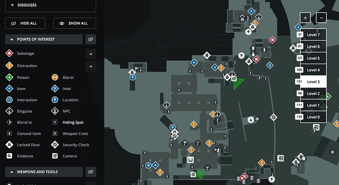

I’m having difficulty getting the side panel to scroll and show all its content.
I have dual monitors with different resolutions, so when I drag this preview from one monitor to the next, it makes a big difference as to how far I can scroll down the dynamic panel and what content it ultimately shows.
It’s also really unsightly to have the scrollbars show.
Does anyone have any tips on how I can:
Create a sidebar with accordion dropdowns that push/pull widgets
Pinned to the left side of the screen and can scroll to show all content no matter what browser/resolution I am viewing it in (I’m not interested in it catering for phone resolutions, only web)
Whatever I try, either with custom dimensions or auto for the page, the amount of content I can actually view is different. Or the position of where the unsightly scrollbar shows is either at the bottom of the page or somewhere between halfway and the bottom, due to the different resolutions.
Hope this makes sense and that someone may have some advice
