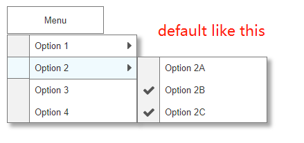

How to configure a similar drop-down menu like axure
Submenu option related
You can’t use Axure’s built-in “Classic Menu” widgets to do this, you’ll need to create your own from scratch: Custom_Menu-Submenu.rp (73.1 KB)
one more question, when i click the “option2” menu, how to default the submenu option as “tick” state?

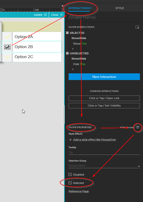

There’s a couple of ways you could go about it:
1) Manually configure the widget to its “selected” state.

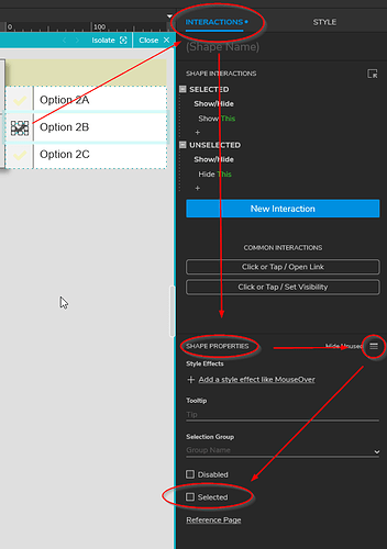

Unhide the icon then go into its properties and check the “Selected” option:
You’ll also need to do the same thing on the whole group:

i don’t have “properties” option
but really thanks for your patience and kindness,i’m a very new beginner in axure
It’s at the bottom of the “Interactions” tab:

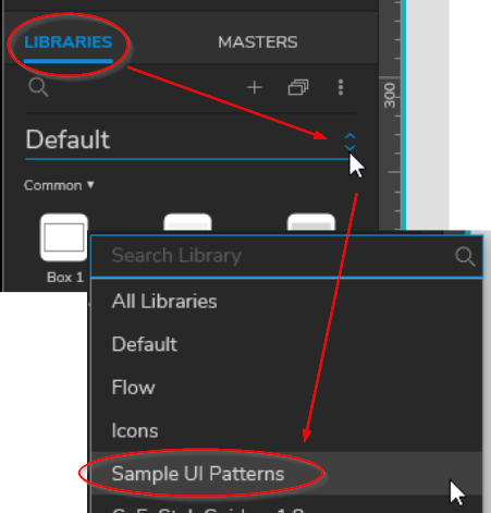

Their documentation has come a long way since I first started so it’s actually a decent resource: https://docs.axure.com/axure-rp/reference/getting-started-video/
They also recently added another, built-in, widget library to Axure 9 that includes samples on how you can make some of the more complex UI patterns:
