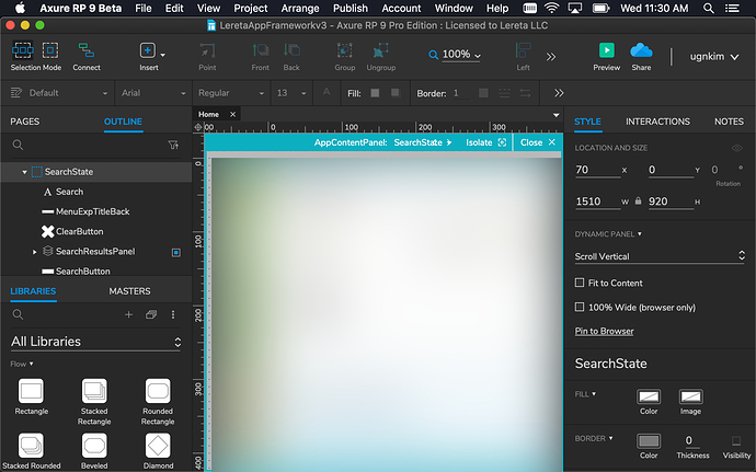

@Jane_Axure Im also noticing a significant slow down w/ the beta. I’ve tried reducing the number of files open at once and unloading libraries but neither has helped.

I feel like it’s always been slow since I’ve started using the beta. I have the latest version 9.0.0.3631. I’ve resorted to setting my external display to the lowest resolution (whatever “Larger Text” under the scaled resolution is in the System Preferences). It’s still jittery when panning the canvas or zooming in/out but at least it’s faster. Hope there’s some improvement on this soon!
Edit: I’ll also unplug my external displays and work directly on my MacBook display.
I noticed the same thing when I upgraded to the latest Beta. Even on a brand new document, I set a page size and then just scrolling around or grabbing/moving the canvas is super super slow. I’m on an iMac Pro so I’m pretty confident there’s something going on with the software that was working pretty smoothly until the latest update.
To solve this problem you need to change the color profile of your mac. For me just changing from colour LCD to color LCD solved the issue. Strange but true
Earlier I said it was slow from the beginning, but now I’m definitely noticing it. If you reduce your resolution waaaay down then it’s pretty smooth.
woah, that actually did drastically improve performance. Still not super smooth but it did improve.
Next thing I tried was to disable dark mode and sure enough, doing that improved performance even with my default color profile selected… so it’d seem this has something possibly to due with dark mode.
Yup, I can confirm switching to Mac’s light mode improved my performance pretty drastically. It’s a temporary fix but now I’m blinded by the light.
