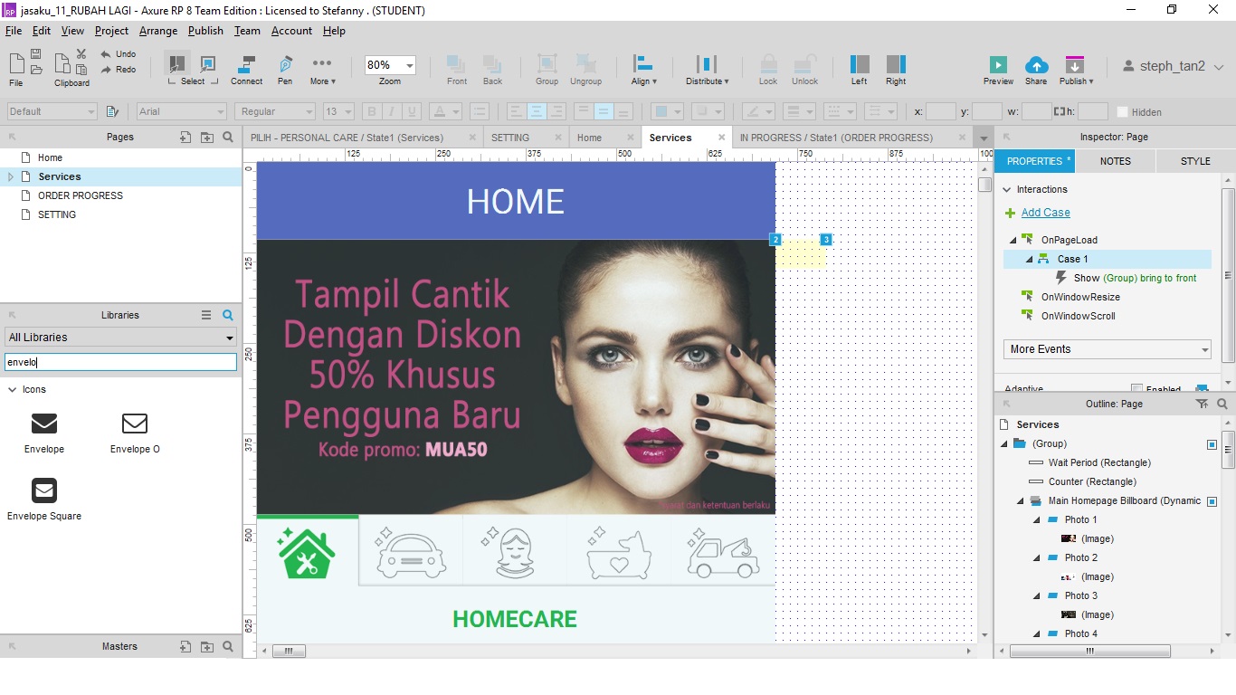

Thanks for your help, last question (i wish :‘D) so i copying this slide to my work. Swiping is work but the automatic slide show didn’t work. Did i miss something maybe at ‘OnPageLoad’ event? I try to using show on the OnPageLoad event but it didn’t work :’)
Yes, you are missing an event on page load. You need to Move Counter by (0,0).
