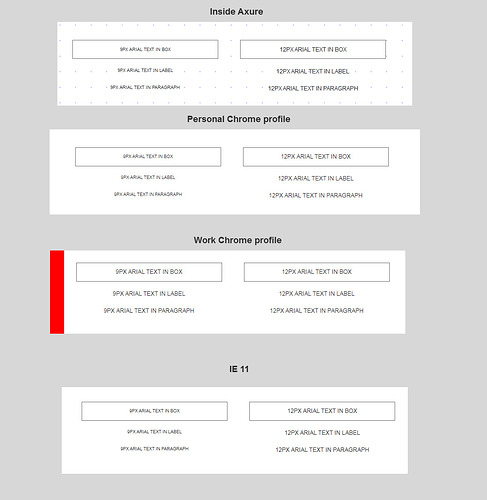

Text in the browser preview shows to me as 12px, while in Axure it’s set to 9px.
Funny thing is that it’s wrong on one of my Chrome accounts, and perfectly fine on another.

Problem persists in incognito mode of the same Chrome profile. Same problem on local preview and Axshare.

I’ve created a new file and the problem persists - I’m sharing this RP file with you. fonts bigger in browser.rp (48.4 KB)

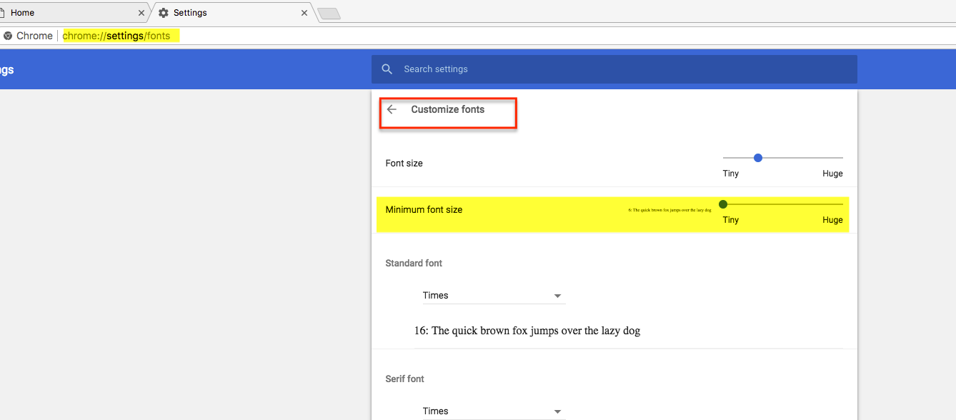

Thanks for that! When viewing your file on my end I see the fonts render as expected (9px and 12px), but your screenshots and info about the differences between accounts gave me a hint. It looks like only the 9px font was affected; in Chrome, if you open the Settings menu and scroll down to and open the “Customize Fonts” section, there’s a slider that controls the minimum size of fonts for the Chrome account that you’re signed in to. From the screenshots, it looks like your minimum font size might currently be set to 12; decreasing that value on the slider should let your 9px fonts kick in when signed in to your Work account.
