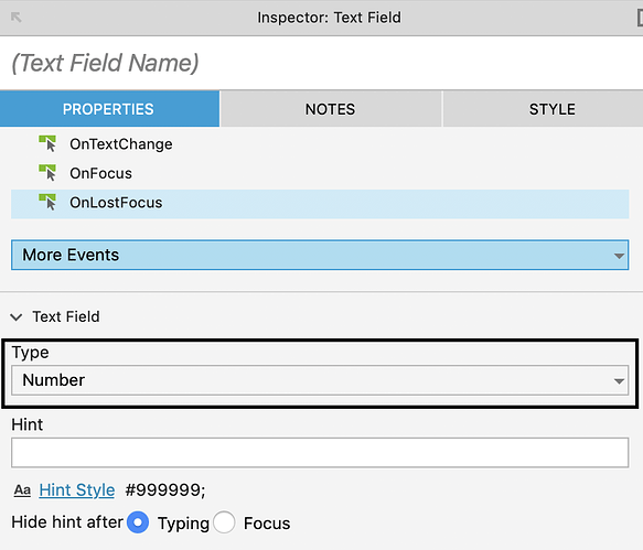

Recently I had a problem with axure. I wanted to restrict the textbox to only positive integers. Although I know how to set it to a number, how do I set the limit to positive integers?
iTonn
@Jane_Axure I hope you can help me with this problem
I think its sufficient to set the type of a textfield to ‘Number’. I guess you have already tried that?

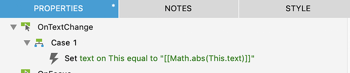

If this isn’t your preferred solution you can readjust the value either onTextChange or onLostFocus using the Math.abs() Function
