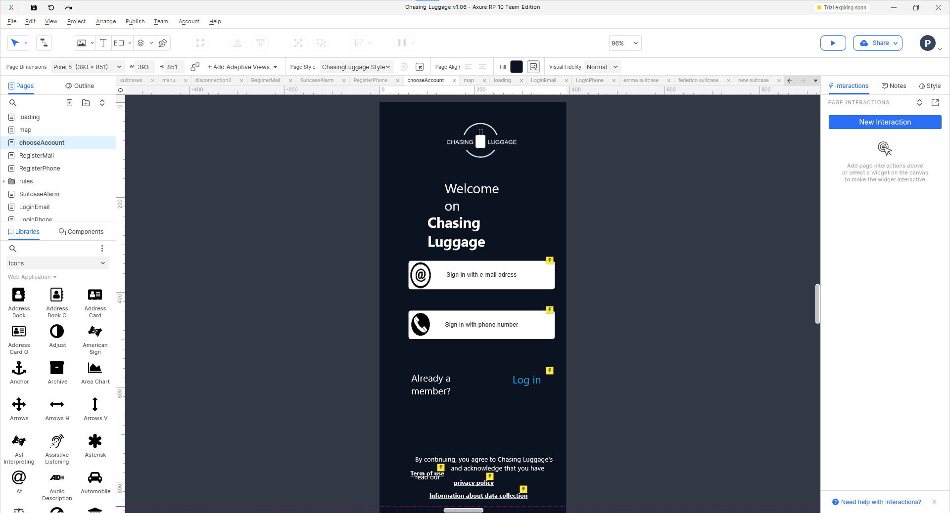

Me and 2 other students are working as a team and we created an Axure project. The issue is that on my PC the UI is shrinked whereas on the PC of my collegue it’s showing the interface as it should.
I’ll attach two pictures to show this issue. I did try to change adaptive views, remove them, change the size of the page but nothing has helped solving the issue.
It’s unclear to me what exactly it is that is “smaller”. Is the issue the title labels wrapping to new lines in the bottom picture?
I think that might be a difference from the widths of the different fonts (top one has serifs, bottom does not) paired with a label not set to Fit to Width.
There’s also a difference in the zoom levels I see (Top: 72% , Bottom: 96%)
Easiest way to diagnose what is going on is to just post your rp file
Exactly for smaller I mean that the text is wrapping on my view whereas on the view of my collegue it’s not. It seems like on my viewport there is either less space for text or the text is bigger.
Regarding the zoom I did try to set 72% but nothing chaged.

I have solved the issue by downloading the zipped Amiri font and moving the “Amiri-Regular.ttf” file into the “C:\Program Files (x86)\Axure\Axure RP 10\Fonts” folder.
Seems like Axure was showing everything wrong because the font was missing on my PC.
