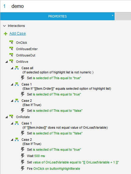

Now take a look at Page 1 for an example of a more controlled iterative loop. Same repeater, except I changed the interaction code for “demo” so each copy can highlight itself (change its fill color to yellow when its selected state is “true”)–more on that later… First, I’ll explain the new widgets on this page. There is a droplist named, “highlight list” and a button, “buttonGo” --These allow a single specific instance of “demo” to be selected. There is also a button, “buttonHighlightIterate” which will highlight a specific instance of “demo” then walk through the rest of the list, iteratively highlighting successive copies of “demo” in the repeater.
To highlight just one copy of “demo” I move every copy of “demo” (again, iteratively) and if the number of that copy matches the one I want, it highlights itself, otherwise it does nothing. (This is a workaround for the lack of a direct way to call repeater instances as you would an array, like “move demo[5] in Highlight Repeater”.) Here is what the “demo” code looks like:
So, if the selected item in the droplist is not numeric (which would be “All Items”) then demo selects itself. The selected state is fill color #FFFF99. Keep in mind this means every copy of “demo” will select itself, so all will be highlighted. If the selected item in the droplist is a number, and if that number matches the number in the “Order” column for this repeater instance, then “demo” selects itself, otherwise it deselects itself. This should result in only one copy of “demo” being highlighted–the one with the same number as the droplist.
To highlight every item in the list iteratively one by one, I would select “1” in the droplist then click “Highlight each item starting at 1” button. This sets a temporary copy of our intended number by setting the global variable, OnLoadVariable, to “1” then calls a new function for “demo” by rotating it 0 degrees (another trick to trigger a specific event on a widget.) The OnRotate code tests its index against OnLoadVariable (this is another way to determine the specific copy of “demo”–or in other words, “which repeater row”, or which “array position”–is current.) If it matches, it highlights itself, waits half a second (to slow down the iteration and give you a chance to notice the highlight effect), then increments OnLoadVariable, and triggers the OnClick event for “buttonHighlightIterate” --thus highlighting the next copy of “demo” and so on through the list. The OnClick code for this button includes a test to determine when the “iterative loop” has reached the end of the repeater list:
…the code, [[LVAR1.itemCount]] is a way to find how many items are in the repeater, where LVAR1 is a pointer to our repeater, and itemCount is a built-in variable for any repeater. When OnLoadVariable has been incremented past the number of items in the repeater, the loop is stopped and “Rotate demo by 0 deg” is not called.
