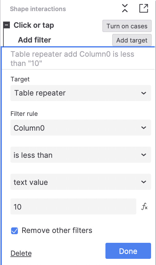

想对中继器中的某个列值与一个固定数值进行比较,小于固定数值的显示,大于固定数据的不显示。想通过设置触发条件实现,但是不管如何都无法筛选数据成功。尝试把条件改成包含不包含的文本后,能够正常进行筛选,但是布尔运算仍旧是不正常。有人遇到这种情况吗?是BUG还是有什么特殊步骤,或者可以怎么调整才能实现?

I want to compare a specific column value within a Repeater against a fixed number: values ​​less than the fixed number should be displayed, while those greater than it should be hidden. I tried setting up a trigger condition to achieve this, but I haven’t been able to filter the data successfully. When I switched the condition to check for specific text (e.g., “contains” or “does not contain”), the filtering worked fine, but the boolean logic still isn’t working correctly. Has anyone else encountered this? Is it a bug, are there specific steps I’m missing, or is there a different way to configure this?
It sounds like you’d like to compare a specific repeater column to a set value and have the repeater filter based on that value, does that sound correct? If so, you should be able to add an “Add filter” interaction to the specific column and then filter it with “is less than” a text value of the set value. So if you were trying to filter the column by a value of less than 10, for example, here is what that interaction would look like:
This will filter the repeater’s Column0 to only show values with a value of less than 10. And I’ve attached an example file to demonstrate this. If I misunderstood or you have any questions, please let me know.
RepeaterFilter.rp (49.4 KB)
我之前也是这么配置的。 不过这个问题在新版本中貌似修复了。
