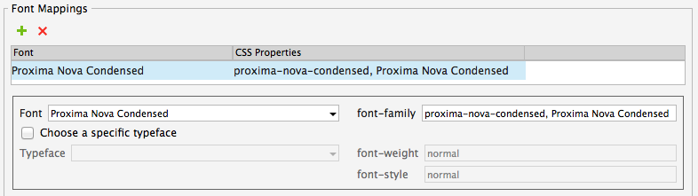

One other tip:
If you have the font on your computer and you want to see it when you do a local preview, do the font mapping as follows:
That will produce the following CSS, which will work nicely whether you’re viewing the page locally or on Axshare:
font-family: “proxima-nova-condensed”,“Proxima Nova Condensed”;

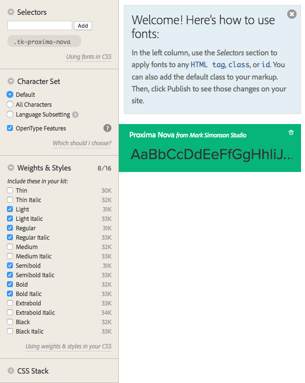

Having an issue with Typekit that I’m hoping someone can help with. I’m using it for Proxima Nova and it works well for regular and bold font weights, however it is not working with semibold for some reason.
Here’s what my preview options looks like in Axure:
And here’s my Typekit:
Thanks in advance!
-Adam
Try adding a separate font mapping for semibold. In the new mapping select the “Choose a specific typeface” checkbox and select Semibold. Then add the appropriate font-family and below that you can set the font weight/style to ensure it’s semibold.
