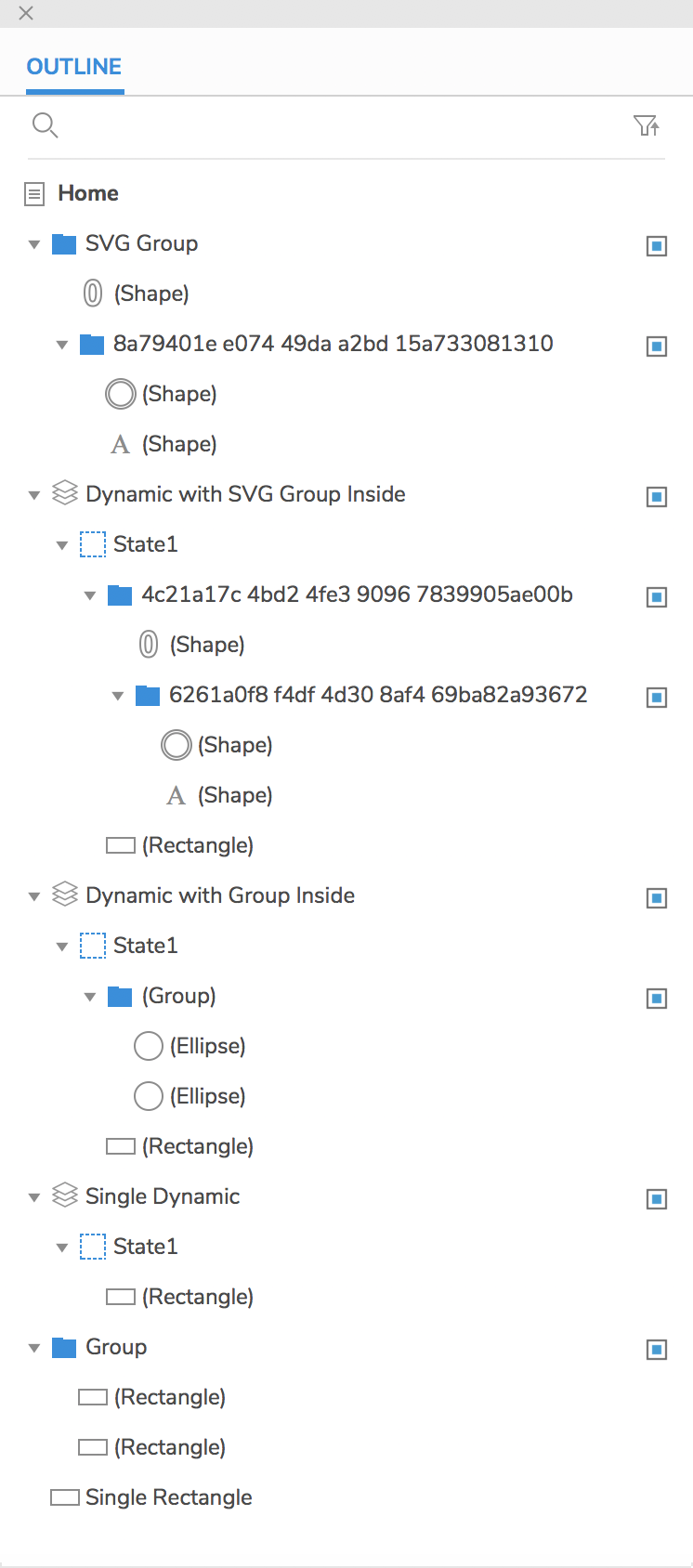

Hi w00t,
I tested your file, and I see that the “Hide from view” icon appears for the groups:
Since you’re seeing something different, could you let me know the version of Mac or Windows you’re running, the build of the 9 beta (3620 is the latest), and whether you see this in a new file or when restarting Axure RP? Any additional info will be helpful!

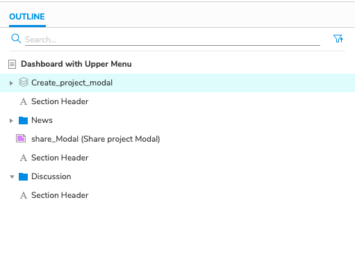

I as well cannot see the option to hide DP or groups. see below:
I have tried aslo to create a new page with New fresh DP and group. Same here:
I have tried to create a new file (since the previous was originally Axure8 file), and the same here.
---- Below is my MAC & Axure Beta info:
Axure 9.0.0.3624
MacOS Mojave Version 10.14
MacBook air
Thanks,
Iris–
Hi Greenozaur,
This was a new bug that was introduced with build 3624 where the “Hide from view” icon is missing from the Outline pane, and we’ll have a fix for this out soon. What may help in the meantime is to click in the general area (the icon is missing, but the functionality is still there). Thanks for your patience!
